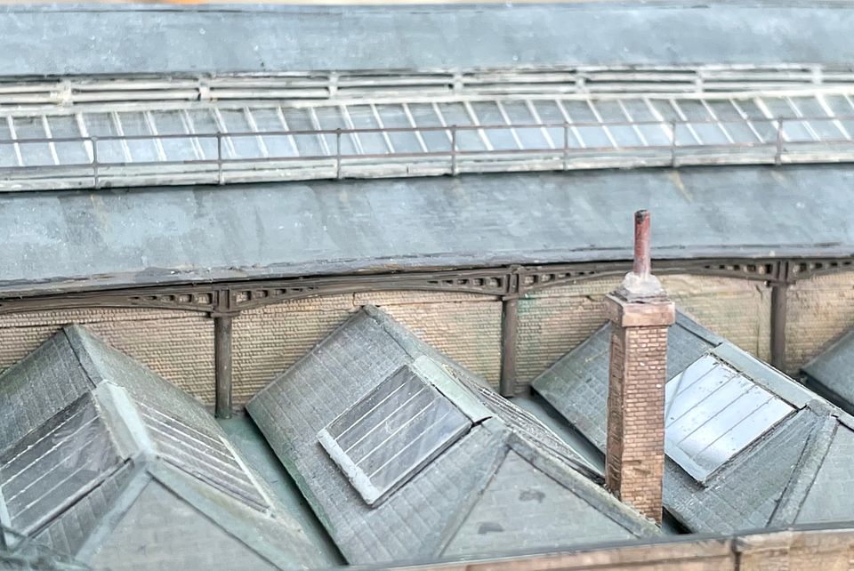

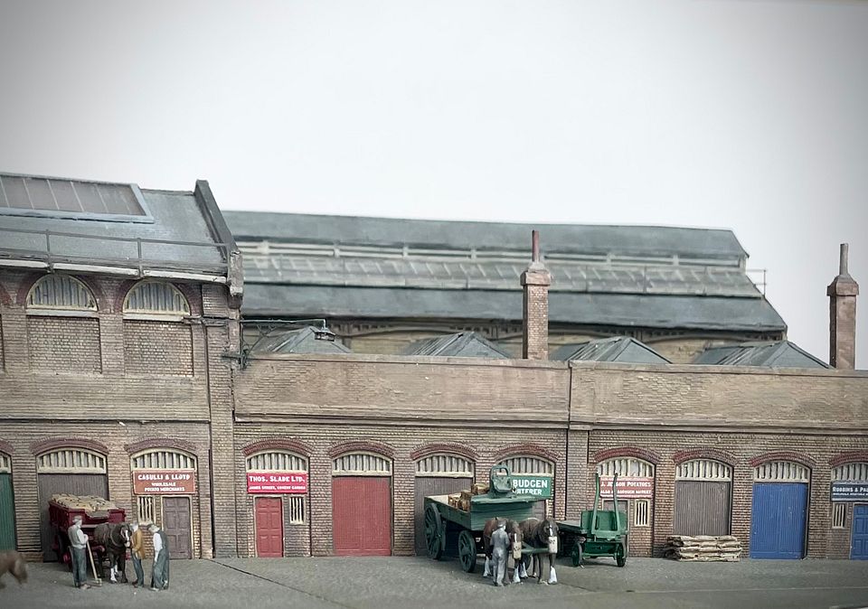

Another of Jim’s etches is now in place. The original 1851 GNR terminal at Maiden Lane was incorporated into the eastern goods sheds in KX Yard, once the 1852 Cubitt station at KX opened. The iron work can just be seen below the eaves of the shed, with the sides filled in by brickwork. The fancy lamp is also visible on the corner of the building: nice and subtle.
A close up, not the most exciting photo, shows how Jim has made a really good representation of the cast iron spandrels, some of which still exist at KX.
These probably wouldn’t have been particularly visible where we have modelled them, but it does show a bit more history in the overall scene, albeit our interpretation rather than strictly accurate. The canopy on the end will be the next construction for the sheds.
Tim

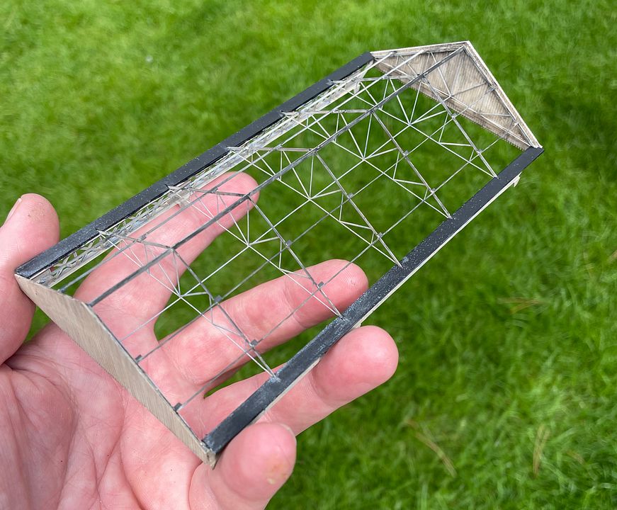

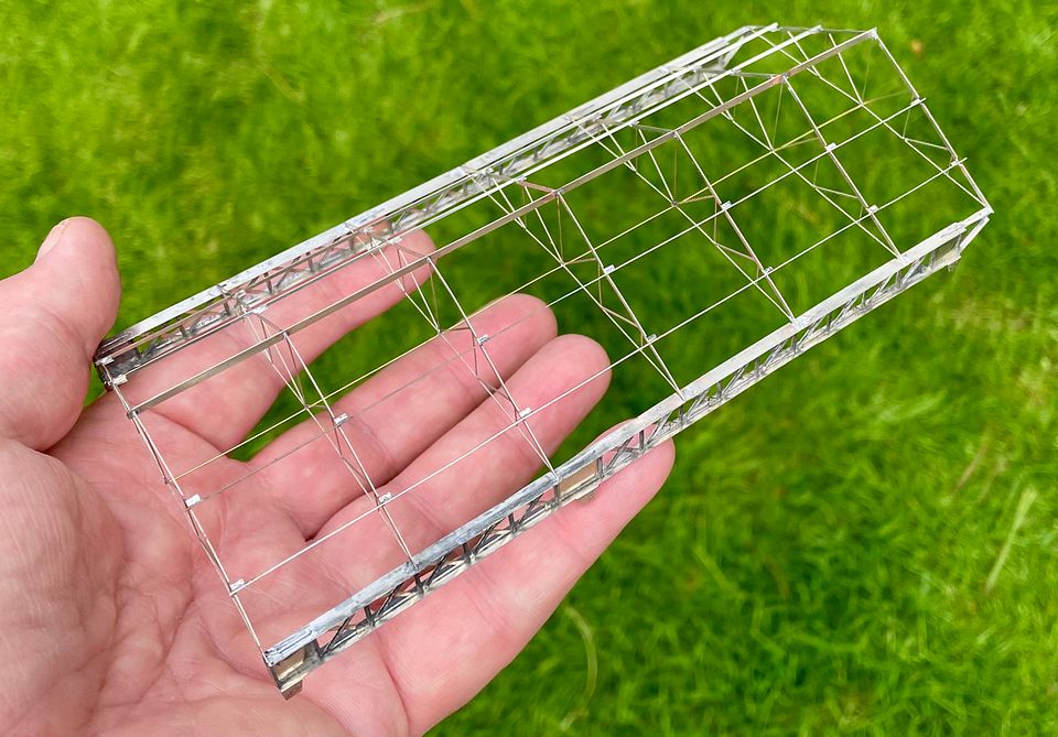

Jim Watt’s canopy has now gone together. The etches assembled very easily (Jim had already done the hard work on the beams). The structure was quite rigid, but desperately fragile at this stage.

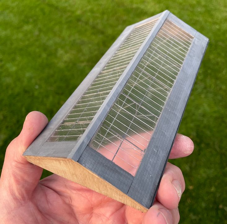

The ends were made from Evergreen planked styrene and black styrene pads for the roof eaves added, which also serve as gutters. Getting a bit more protected now, with the ends in place.
The glazing was guillotined to the exact tight fit between the ends and scribed for the glazing bars. The whole assembly has now become quite strong. Roof slates were also attached, using Slaters sheet; heavily sanded, of course.

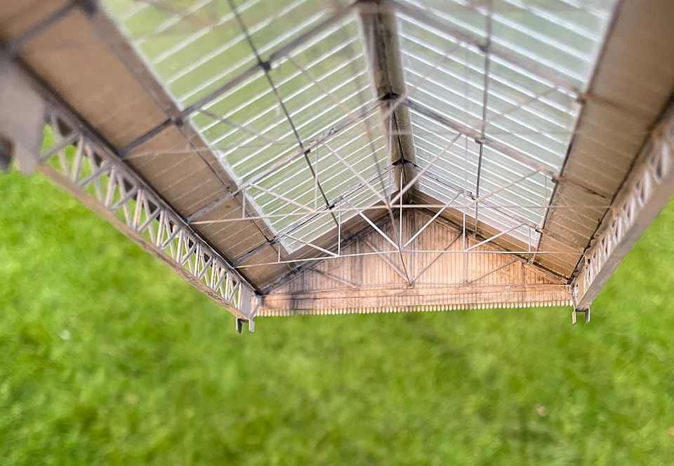

This view will be difficult to get on the layout, but shows the finesse of Jim’s etches. The canopy valance was from a Scalelink etch: the last time I used this was on Luton Hoo station 40 years ago!

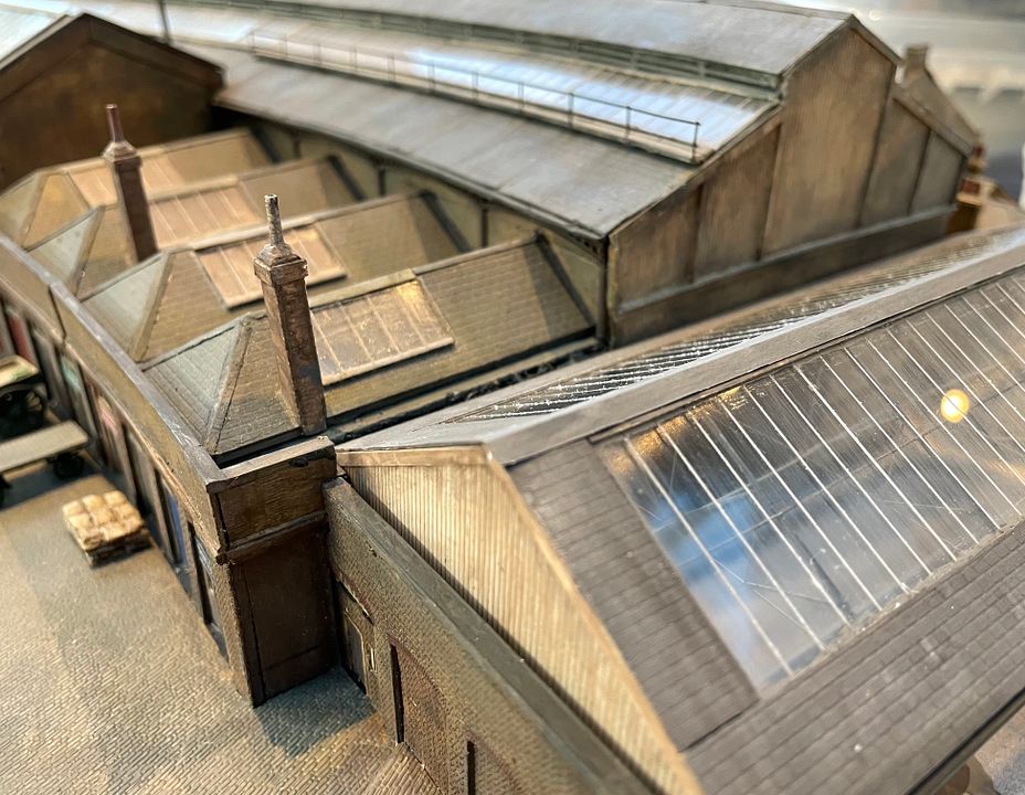

Just a rough snap showing the positioning of the canopy across the main shed end. It will need fettling in to the main structure with suitable flashing and the I beam legs making to support it. I will try this new building out on the whole board tomorrow.
To say I am pleased with it is an understatement; thank you Jim.
