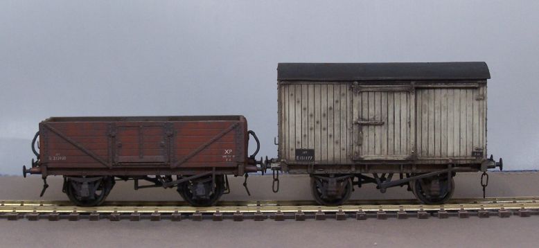

Morning Terry,
My fault for not checking numbers. PC61 is the basis for my unfitted conversions. I don't seem to have any pictures of the steel underframed one. the wooden underframe is most easily done by swapping with a Cambrian open kit and using the PD bits to make a fitted open:
Edit - the steel underframed van is also possible from the 3H kit, if you can find one for sensible money:

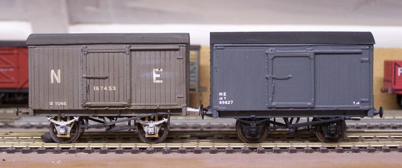

The GN van is the 19' one which they built in some numbers before 1923. They were almost all fitted although some unfitted ones were built for the CLC:
These two were scratchbuilt by a friend who then gave them to me and I completed them. Hopefully what Andrew has sent amplifies what I've said. Just ask if you need any more.

Thank you Jonathon, the last two, look good, I have a Dapol chassis I want to use up (10' steel ) + I have a 9' wooden chassis I'll make up into one of the other vans. :D. The World of Wagons, mystery on wheels !!
