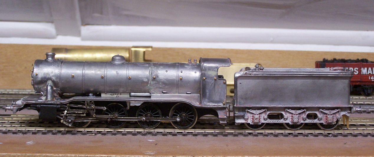

Morning Andrew,
I haven't thought that far ahead about the O2, tbh. It was never really intended to be a major project, it's just one of those which keeps growing every time I look at it. I have one of Mr King's resin cabs intended for a Heljan one, I'll compare the two.
I picked up a couple of SEF K3s cheap on Ebay and I'm shuffling tenders between them at the moment before refinishing. Tom Foster had assembled all the right bits for this one, just not finished it, so I kept the same identity.
The J5 is John Coffin's design, not Frank Davies. I haven't tried one of Frank's yet although I'd also like a J1 when they become available. I do like these little GN 0-6-0s. This one allows you to remove boiler and smokebox for painting. As mine will be black I'll probably solder it all together once I've made the drive unit fit.

Still awaiting a couple of packages, so stuck on some jobs. Did a couple of wagons just to while the time away...
These were presented to me by El Jobbo the Merciful of Copmanthorpe. I hope he likes what I've done with them. Although I think I came out ahead, the lettering was a reminder that Powsides products really are the work of the devil himself.
I've also been working on this - K3 227 with the Hulburd water treatment gear. It needed a stepped GS tender, so I've robbed one from a kit built K3 which is awaiting refurbishment. I hope to have this ready for Leeds. It would run now, but the colour makes it stand out a little.
One thing which did arrive was the motion fret for the O2. I've stripped the existing motion down, so I'll make a start on this when I have a few uninterrupted hours ahead of me.

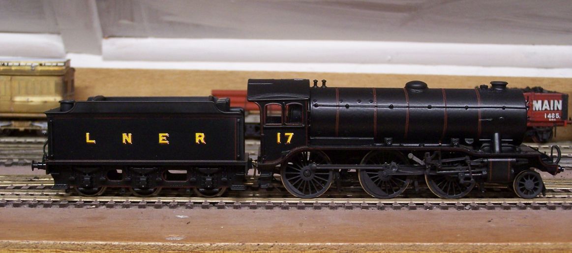

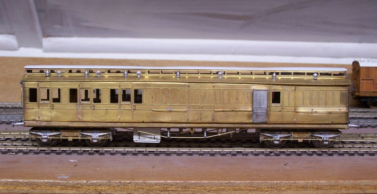

- Posts: 4219
Re: West End Workbench
Another item finished for the weekend. I was gifted this some time ago. It's an ECJS XBV, produced by a chap who sells through Shapeways. Honestly, I couldn't recommend it as the finish was appalling and in addition it's not accurate (there should be a single door to the right of the ducket on both sides. Not to look a gift horse in the mouth, though, it struck me as a suitable candidate for a coupling adaptor van rather than the Bachmann fish vans we tend to use in extremis. So here it is, multiple coats of paint later in an attempt to fill the striations and with the ECJS number as we have not been able to locate the NER renumbering it was given in 1922 when transferred to that company's stock.
It's unusual, if nothing else.
