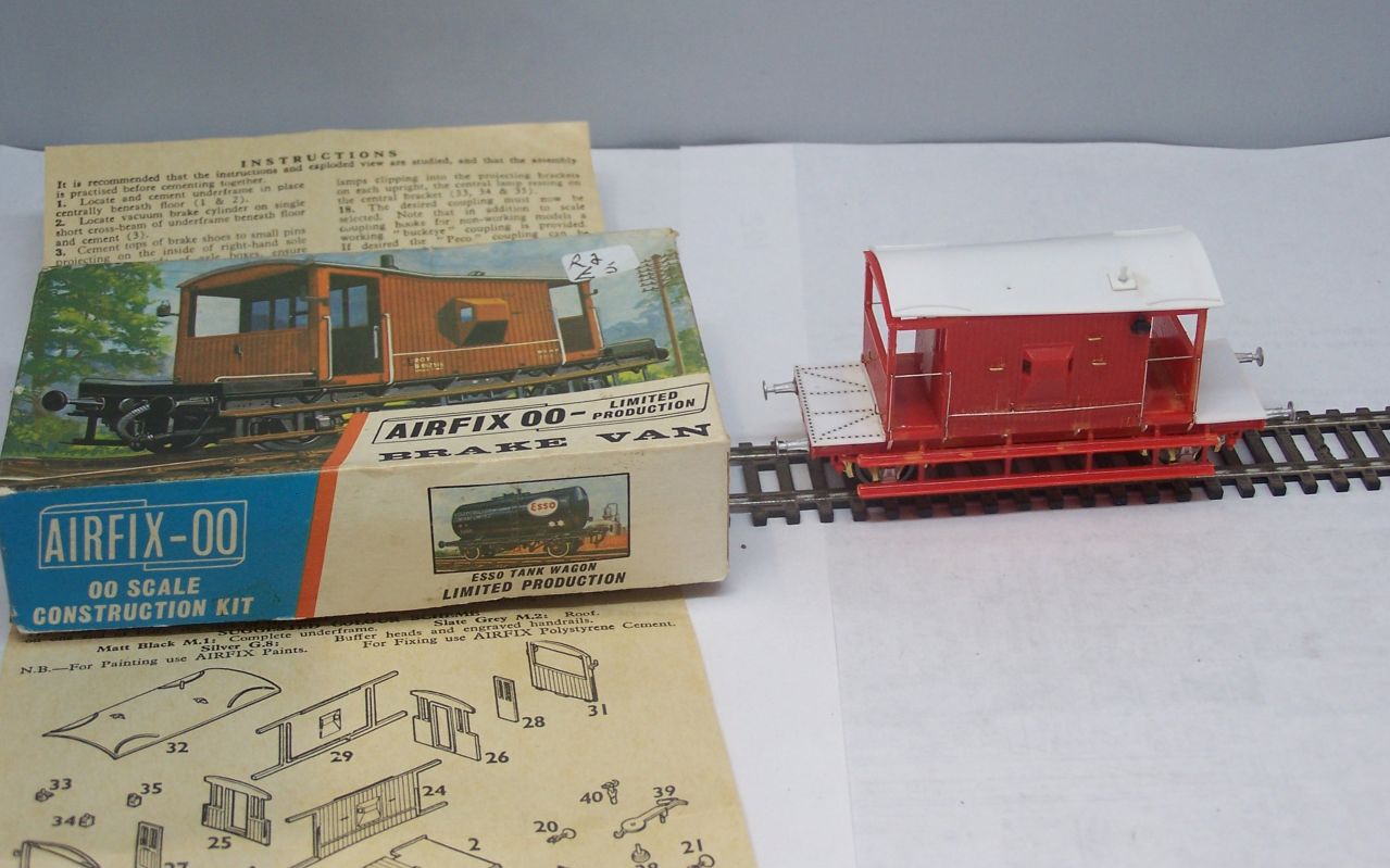

.... and we're back. Not a lot to show for two full days modelling:
One largely finished Airfix brake van, backdated to LNER D61 and one Cambrian LMS van (Mrs. W's first ever kit).
Enjoyable weekend in good company nonetheless and thanks to everyone who took the time to come and visit. Really good to see Dave S and Joshua again and catch up with Steve's news. I had my horizons broadened too; previously I'd have had no idea that 'can you demonstrate wagon building' would expand to include:

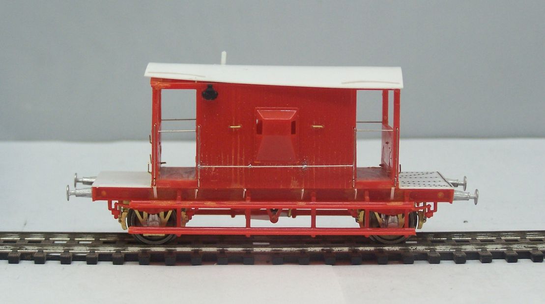

Brake van largely done now, just needs tidying up and the roof fitting properly. It must have slipped on the bottle (haven't we all?) and hasn't bent straight.
I'm thinking I'll keep this one for demonstrations as the garish colour makes seeing the alterations very easy. I have a couple more to do so we shan't be short of the one we need for Grantham.

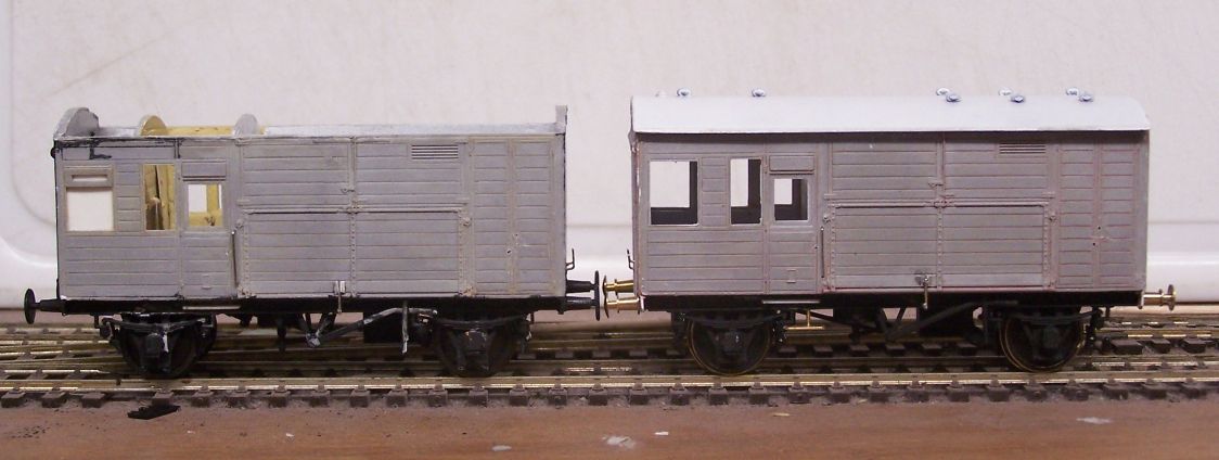

I've been pressing on with the wagons I had at Warley this week as i had all the bits and reference material to hand when we came back.

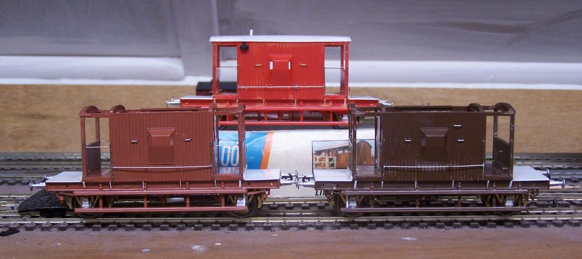

2 more brake vans well on the way - just need the rivet transfers applying, roofs and brake pipe upstands and the usual tidying up. If I do any more of these, I think I'll try the later diagram which had the concrete weights on the ends.

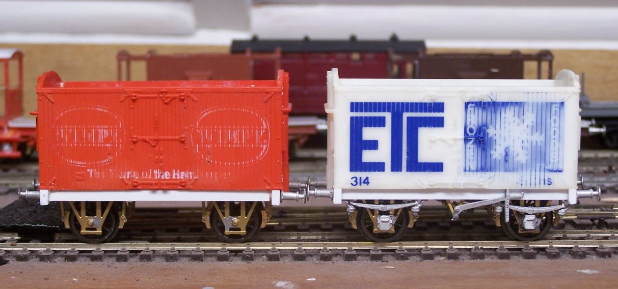

Two of the Hornby F10 van mouldings also well on the way. One still needs brake gear and the other looks as though either a spring hanger has bent upwards or an axlebox has slipped down. The left one will be finished in oxide as if in meat traffic, the right one will be white. These other liveries are much cheaper than the Thomas ones and also don't have the holes in the side where the circus panel is attached.
H & B van also now with undercrackers. I might yet reinstate some strapping on this one - I cut it off to make panelling in the recesses easier. All the bits and bobs for this and the F10s come from 51L/Wizard.
To show that I do take my own advice about buying and renovating show wrecks, a pair of Parkside LNER horseboxes I picked up at Cleveland Club open day in September. They were both fairly battered and had awful paint jobs - one was light green, the other a maroony colour with apparently random lettering. One is now well on the way, the other needs the power steps making and one or two brake shoes reinstating. I found a use for those brass buffers K's kits used to come with here, even though the heads are slightly small. The door springs are made from the square wire Wizard sell for point rodding.

Hello Jonathon,
Very nice work, it is good to see off-the-shelf models re-worked.
Regarding the F10 refrigerator wagons, do you use the floor of the Hornby and rebuild the W irons and braking gear?
I noticed the additional white plasticard which appears to be an overlay or maybe part of a new underframe/floor.

For anyone who hasn't yet encountered one, it is worth pointing out that some (minority?) versions of the Hornby F10 van came factory-equipped with a moulded plastic version of the correct NE underframe, with horribly chunky tension-lock coupling bars moulded on. Those eyesores can be cut off of course. The moulded version isn't as fine and accurate as one built up from scale metal parts, but it looks about right and offers a handy short-cut to a result.
I think the very first F10s issued in LNER ventilated refrigerator liveries had the NE underframe. Later versions seem to have mainly had the Hornby "anything will do" underframe. As far as I could tell, the factory "R" number gave no indication of which underframe the vans would have.

Kimball, I've been meaning to reply to this for a few days and then kept getting caught up doing other things. The Hornby van body (this applies also to the H & B van) is moulded as an open box, so you can unclip the underframe, cut and file away the moulded clips and you have a flat, square base on which to attach your own underframe. This is one from my display which I've left at that stage:
You can see where the clips were on the underside and also the green putty in the holes on the side where the Thomas Circus sign was removed. I make the buffer beams from Evergreen .156 x .080 strip and the sodlebars from the channel (Evergreen 156) I usually use for solebars, but reversed so it's flat side out. You also have to pack it up 20 thou so it's level with the bottom of the buffer beam. I use that as it's narrower and allows plenty of room for a rocking W iron to work. I generally use MJT W irons and the Mainly Trains brake gear etch, but you can take your pick from your preferred supplier.
Here are the two wagons now only needing couplings and weathering.

Brake vans are also done. One or other of these will go on the perishables train on Grantham. I'm pleased with these, they scrub up nicely for a kit that was old when I was in nappies.
If I do another it'll be from the later batch with the end weights, that'll be a bit less work.

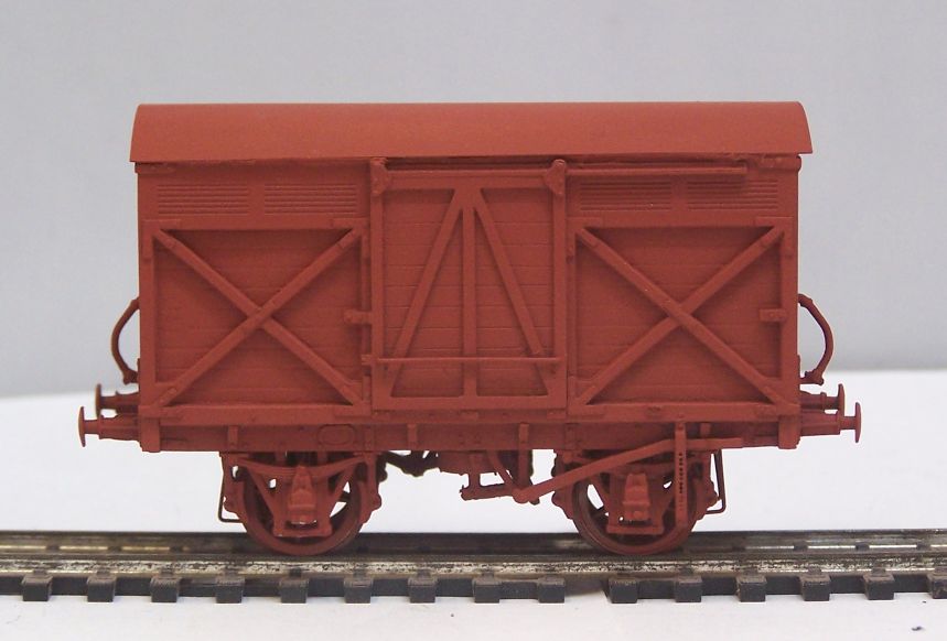

With a break in festivities until this evening I've been back at the bench. Picking up where we left off, the refrigerated van is now painted and awaiting lettering.
The other van was another acquisition at Newcastle show. It's either Ian Kirk or Westykits, a short wheelbase NBR van. There's one in Tatlow 3 branded 'Return to Singer' which I think may be on the HMRS sheet. I'll have a look, maybe later this week. This was built and painted to a decent standard, all I've had to do is fit buffer heads, replace the P4 wheels and put a couple of coats of varnch on to take the transfers.

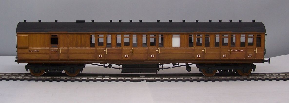

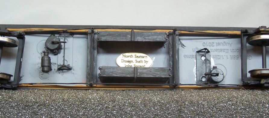

Continuing the effort to finish off a few 'nearly done..' projects, the North Eastern Design carriages I showed a few posts ago. They just needed grab handles and the roofs fitting, which i did this morning. First up, the D121 Lavatory Composite:
D130 Lavatory Brake Third:
The D183 which completes the set is in primer and awaiting teak. I have also made sure I've retained the makers plates - I have repainted these, but I shan't try to take credit for the building of them.

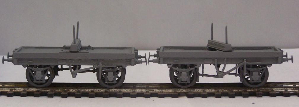

Some more single bolsters - these are Midland, by ABS and sold as a pair. They came in the bag the kit was sold in, with the instruction sheet. I had to add bolster pins and make good a broken W iron (and supply wheels) but otherwise they were ready to paint.
