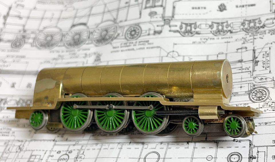

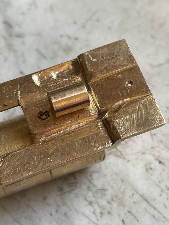

Attention has now turned to the cylinders.  These will be soft soldered to two pads which are, in turn bolted through the frames. The fixing studs are 16BA silver soldered in the brass block. The reasons for the square cut outs in the PCB spacer are now apparent, as they give room for the nuts.  The cylinders will have polished steel end caps, as per the prototype, and it’s fortunate that the rear one is very simple, which will make machining the slide bars rather easier.
The cylinders are bored 1.5mm to take the front and back fittings. It’s also useful for checking alignment using a sighting rod. The cylinders are currently 0.5mm too wide on each side, but there should be ample clearance to bring them in to scale width.
The next job will be to file off the top of the cylinders to allow for their inclination, then solder them on to the pads.

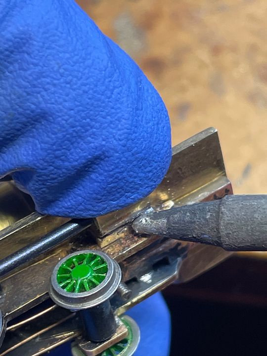

The cylinders have now been fixed to the frames on the NER 4-6-2 class. I decided against trimming the top of the cylinder but cut out the underside of the thick running plate instead. This gave a ‘cradle’ to support the cylinder whilst it was being soldered to the mounting pad.
The two components were held in place by hand against the frames, after tinning both pieces, but wearing two nitrile gloves.  These don’t give that much heat insulation, but better than nothing.  The alternative, which I tried on the second side was to use a piece of emery cloth to grip the cylinder and push it against the frames. The gloves worked better and the cylinder was just tacked into place with an exceedingly hot iron.
The assembly was then removed, clamped up with some locking tweezers and properly sweated together.
An air gap was cut around the cylinders using a fine bur and files to insulate from the bodywork (actually only needed on one side - the other is live). The cylinder had a small rebate cut into it so that it did not touch the valence: this may be coated in epoxy resin later on.

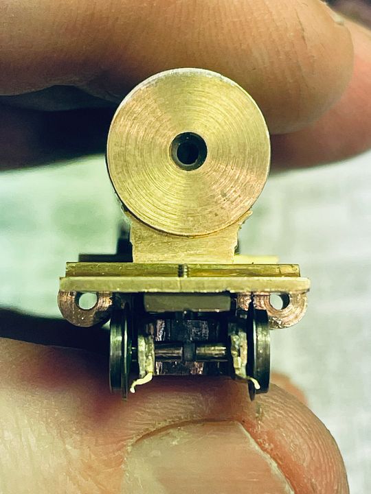

The positioning of the cylinders is very critical, the first one was OK, the second more tricky. From the front they look OK.
From the side the angulation is quiet subtle: the sighting rod helps to check it out.
