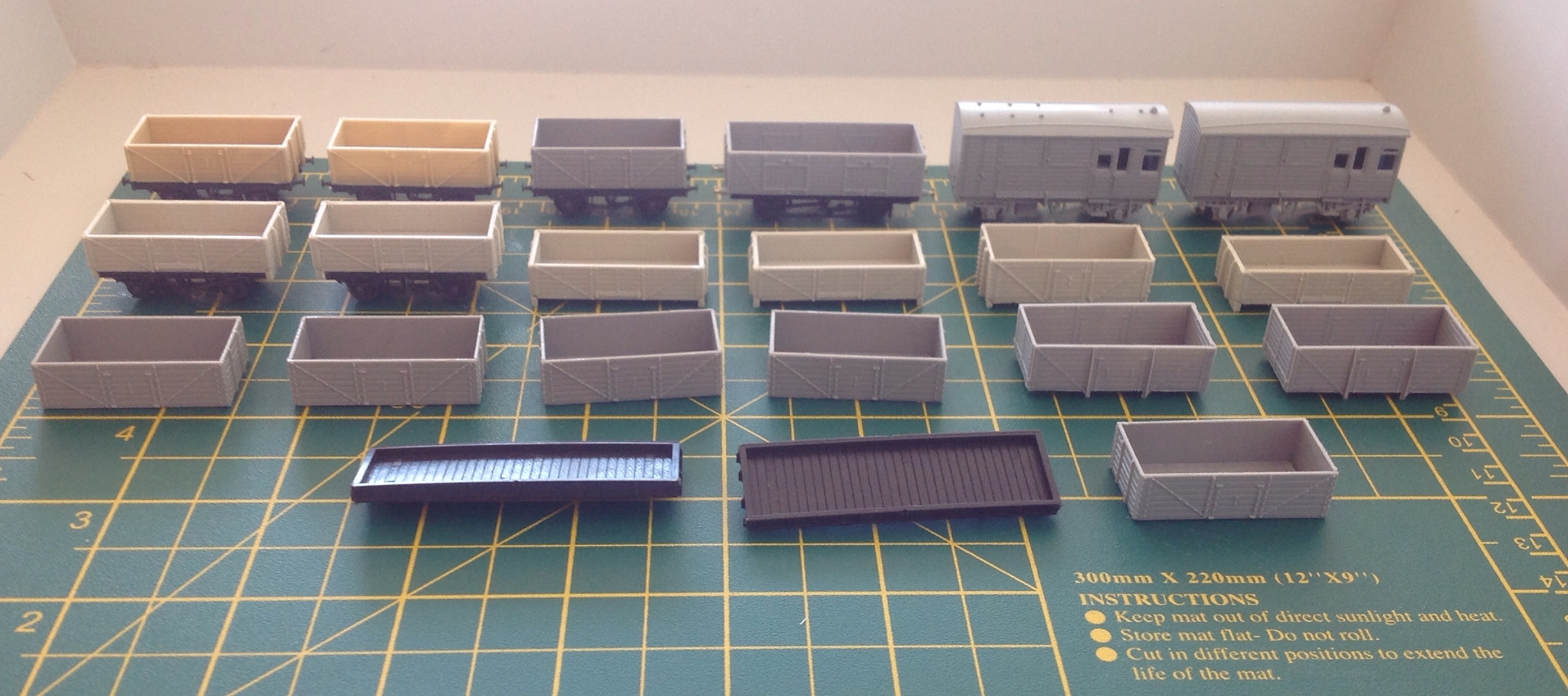

A mixture of Peco and 2mm Association plastic kits. I've also got some etched 2mm scale chassis to upgrade the chassis of some very old Farish LNER vans and the Peco plate wagon (which is surprisingly close to the late 30s LNER one but the Peco chassis is nothing like the type it should have!).
The first up in the build queue is an 2mm Association LNER six plank wagon. As this was going to be an unfitted example (I've got six to build it total), I decided to modify a Peco 9' wheelbase chassis kit as it is pretty close to the type that the unfitted wagons were built on.
Then there are two PO wagons, the front one is the Peco 9' wheelbase kit and the other is the 2mm scale version of the same wagon. Again, I've fitted a Peco chassis kit under the 2mm body and, not surprisingly, the chassis is fractionally longer than the body. As I'm just about out of Peco 9' chassis kits (the 10' kit is just awful compared to modern N gauge standards!), I'll likely be looking at getting hold of some more 2mm etched kits to build and convert to N gauge running.

Things have progressed a little more quickly than expected with this being the state of play at 10 am...
Lots of chassis to now source and build!

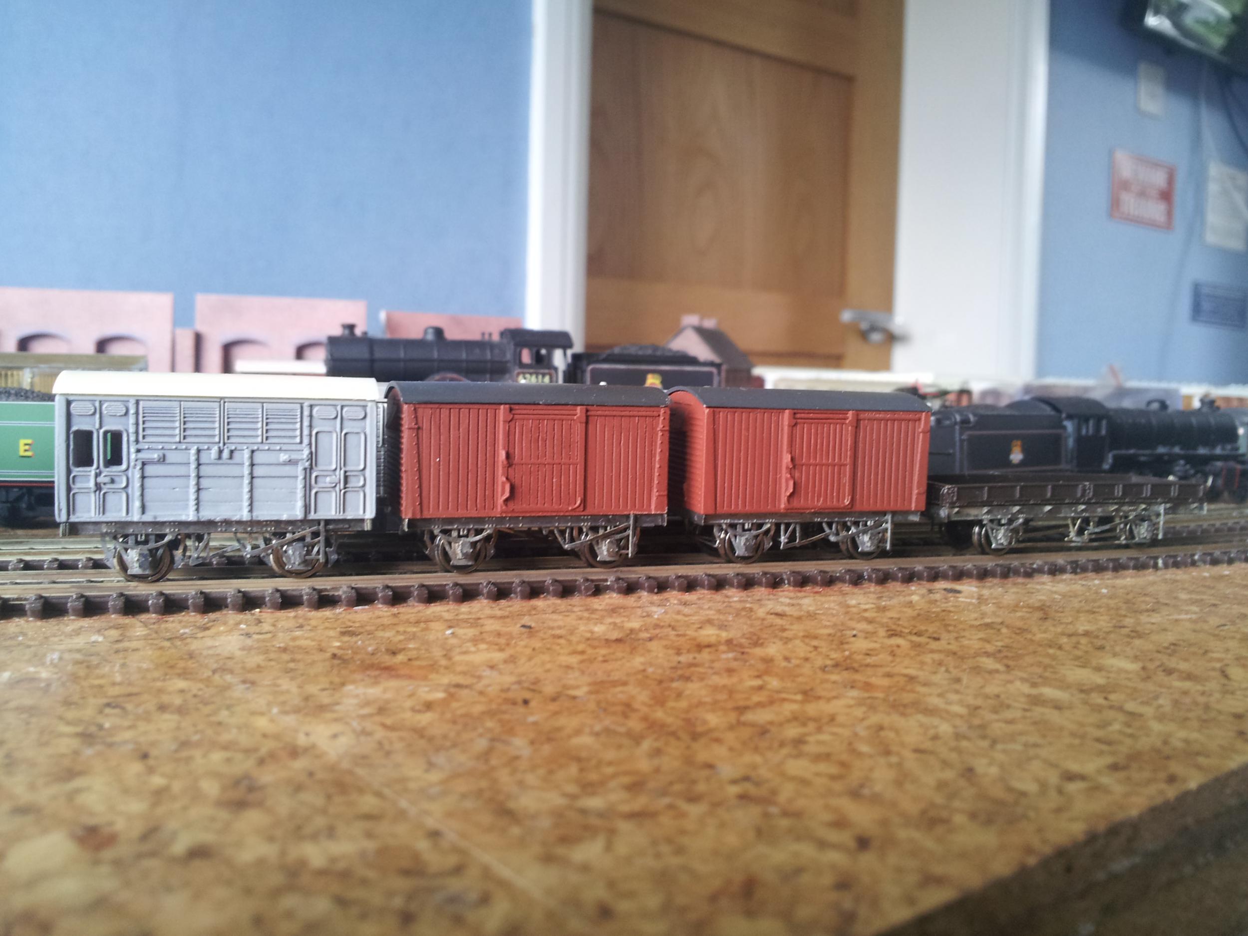

A spare couple of hours saw this get assembled this afternoon...
...and with the very old Farish van body it'll be paired with...
...finally a comparison between the current Farish LNER van, the etched chassis version and an old van with its original chassis.
