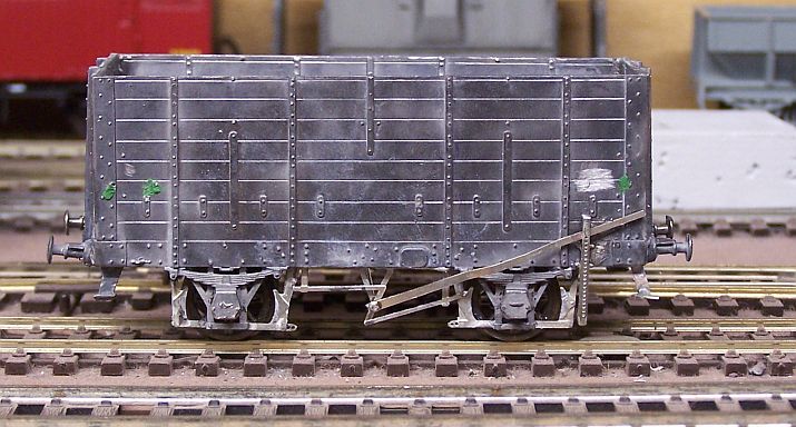

I resurrected this ABS hopper which has been on the corner of the workbench since, somewhat embarrassingly, 2013. It was missing parts of the brakes, especially the levers, when I reassembled it from a second hand job lot which had come my way. I've had my eye out for the appropriate ABS parts ever since, but Mark Tatlow has now made what i needed available as a nickel-silver etch. I picked one up at S4N a couple of weekends ago.
The etch is designed for the Slaters kit and as yet there are no instructions, so I can't comment on how well it works with that kit. It's certainly done what I wanted here, as a representation of the brake gear and the very prominent levers. I now need to wait for the filler to set in the huge handrail holes someone had made and then put proper ones in.

Re the Hopper etch.
It maybe the picture but the whole layout of the etch seems to be very flat ? The Brake shoes appear to be a long way from the wheels and inline with the front of the axleboxes , as does the rest of the etch , other than the brake handle ?

You're right, Mick and that was why I was careful to say that I hadn't used it for its intended purpose. The brake shoes are a double thickness etch but they had to be slightly forward of the wheels so as not to foul them and the strongest place to practically attach them is the back of the axleguard. I haven't looked at how it fits onto a Slaters kit, but it's better than nothing at all on this one. Once it's painted and weathered and in a rake of others it won't be so noticeable.

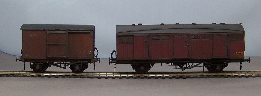

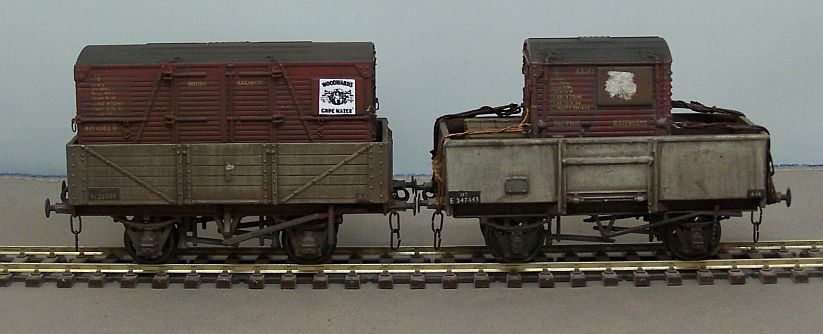

The information about Parkside sprues is useful - having built two conflats with alternative chassis, i could now use two more bodies to use the BR chassis under. On the last lap with stock for Ely show now - mainly containers as I don't think we have had enough. These are the low hanging fruit from the batch as I didn't have to wrestle with any chains to complete these. That pleasure awaits this week. I'm also weathering other completed stock as I do batches so they can go into the boxes ready to travel.

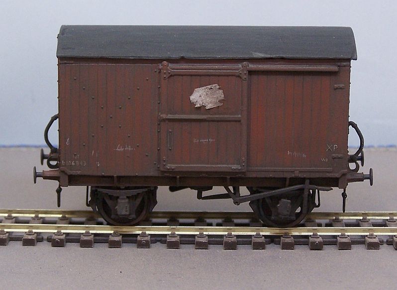

The General van has been seen before, a find at Middlesbrough Show a couple of years ago. The Parkside van was in a job lot and was bought for use as a weathering prop. On a whim I sorted out the (missing) brake gear and added better buffers and here it is. The chips in the roof are nowhere near as noticeable with the naked eye.
Traders labels have been a feature in pictures I've been looking at and one has found its way onto here too.
The two opens are for some variety; the steel high was another exhibition rummage box find which tidied up adequately and the LMS one I built. Bits and bobs of tidying up to do, I see - it's remarkable what the camera sees, isn't it?
