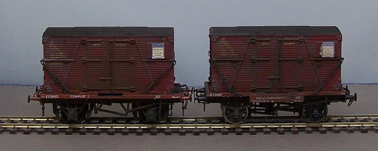

jwealleans wrote: Sat May 04, 2019 9:06 pm About wrapping up the wagons for Ely Show now; there are a few which won't make it, but they'll be new wherever we next take the layout. Containers are a right faff, being honest, but I really can't abode seeing them rolling round on wagons with no evidence of anything holding them on.
I've adapted the method of making the chains and gone more along Geoff Kent's lines. They're certainly more robust and as a bonus easier to make.
I'm sorry if I've missed an earlier post. Is it possible you could describe this method of securing containers?

Ambis do chain as well, plus shackles, I am waiting for some to arrive at the moment. I agree re the previous post what is the method used for the chains please.
Posts: 4217
Re: West End Workbench
Post by jwealleans »
You have missed a post, although as it was September 2013, I think you may be excused.
The difference this time is that instead of plastic rod I used 1mm OD tube and soldered the bits of wire linking the hooks and shackles into it. In fact I used the same length of wire for strength after I made the first one.
Another little trick was that this time I made the hole for the copper wire loop after I'd made up the shackle/hook/shock absorber assembly, so it coould be placed such that tensioning the whole thing was easier.

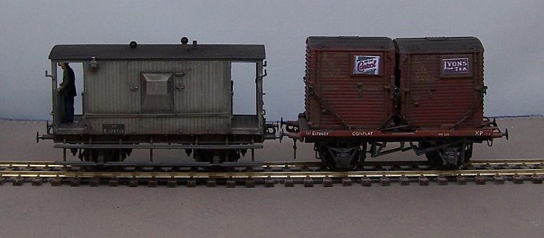

Final preparations and finishing off. Because I was very good and cleaned all my wheels on Sunday evening, i had time to complete this bonus wagon last night:
A variant of the Conflat A with clasp brakes and one of the UNIT Models containers discussed back upthread.
